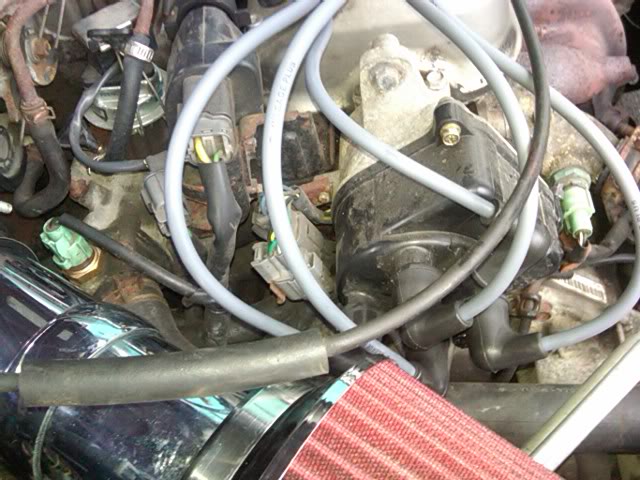

so the Switch A is to the left of the distributor, switch b is to the right, the sensor is directly under the distributor

thanks. is this a picture of a 92 honda accord?

no, this is from a 97 accord 2.2L f22b2 engine, but should be somewhat similar. from what ive noticed the switches have the green connectors on them, so id look for the green in your car

and i believe if you follow the coils wire harness, the split of wires should go to the switch you need to replace

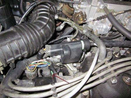

here is pic of the new ignition coil, and a "green" connector underneath it. That was the one I removed and jumper. It is really buried in there. I think that is the correct one. Do the temp sensor/gauge have a "green" connector?

on my car the only green conections in the area are the switches, so in your pic it does look like the switch, have you recieved the new switch yet? if so does it look like the one in your car? if not id go to or call your local napa, and see if they have the correct part, they do have delivery options but i dont know if thats for shops only.
