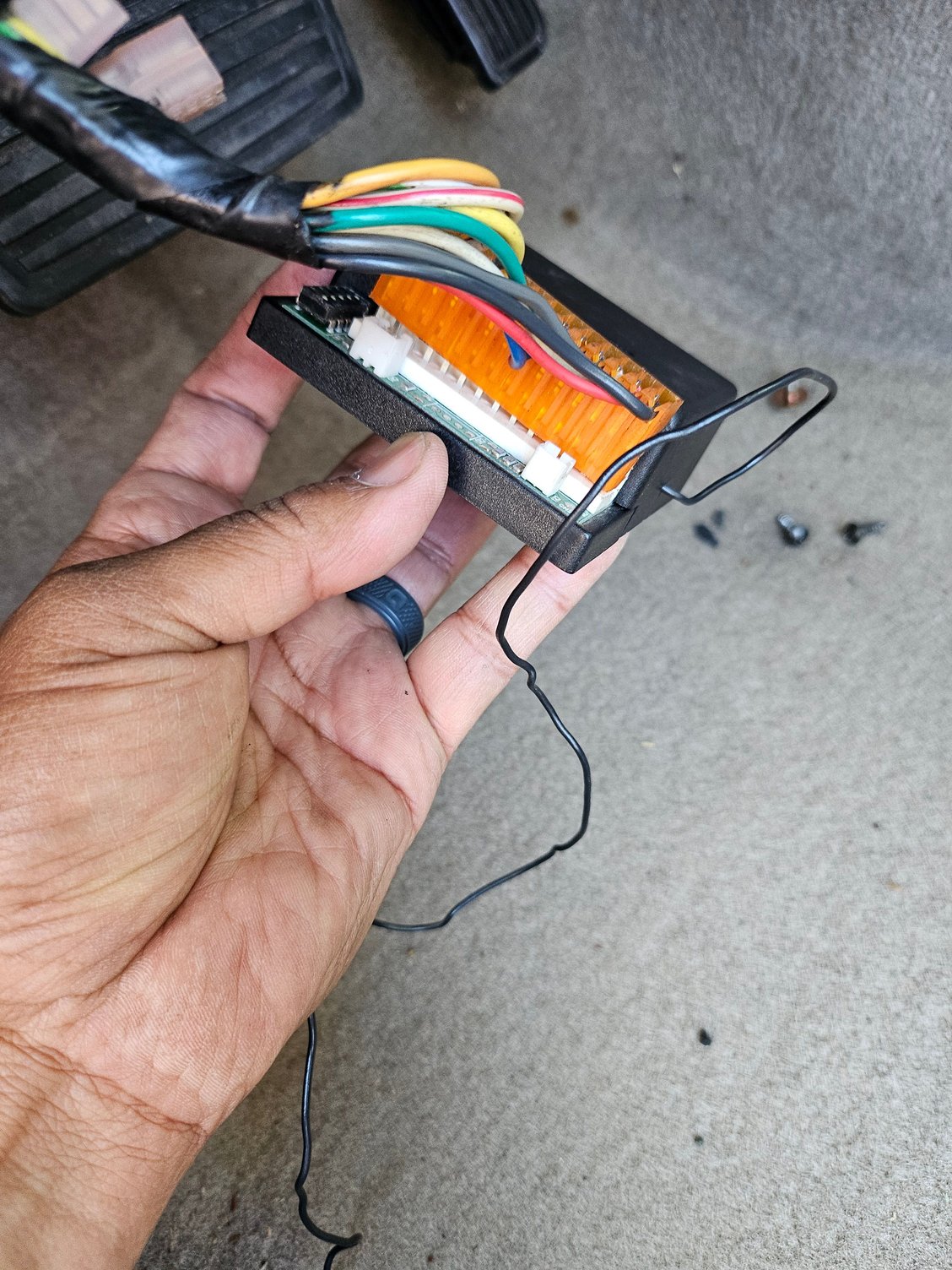

That's the black box and the harness that's hooked up to it. Where the heck does that harness go if it's not connected to the box?

Old Apr 15, 2024 | 04:38 PM
  #40
Posts: 16,331
From your video and these pics, you definitely have some aftermarket setup on your car that you can try to sort out. The FCCID stamp on that box means that it almost has to recieve some remote signal. I'll guess remote start or a security system. Maybe you can get a part number off the circuit board of that black box. You'll have to trace the obvious aftermarket wires to the OEM harness to figure out what was done.
The aftermarket wiring doesn't explain why the starter isn't performing and for me is a rabbit hole. You are the 12V signal for the starter to engage and the large wire should be directly connected to the battery. The starter should crank over the engine based on your testing. The engine may not run on its own with the aftermarket wiring, but troubleshooting will be a future step.
