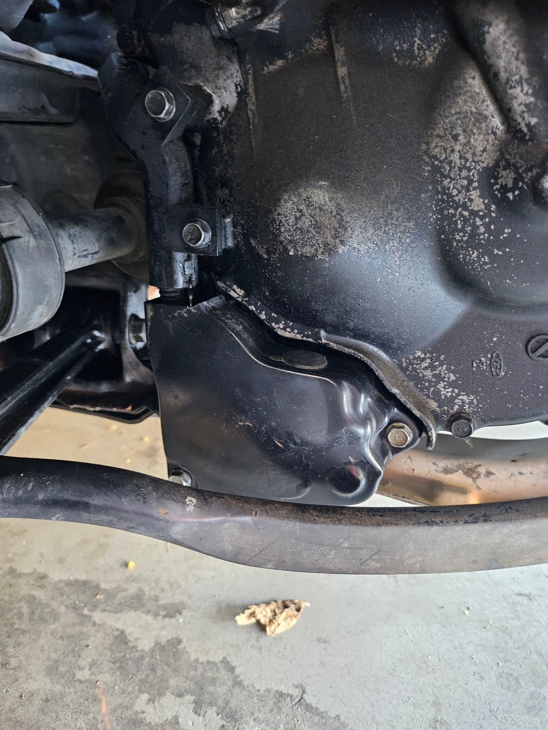

This?

That is the range switch.
You may have to watch the engine/transmission while an assistant puts it into reverse to location the noise and/or excess movement. You could have a bad motor mount that is making a noise when you shift to R.
