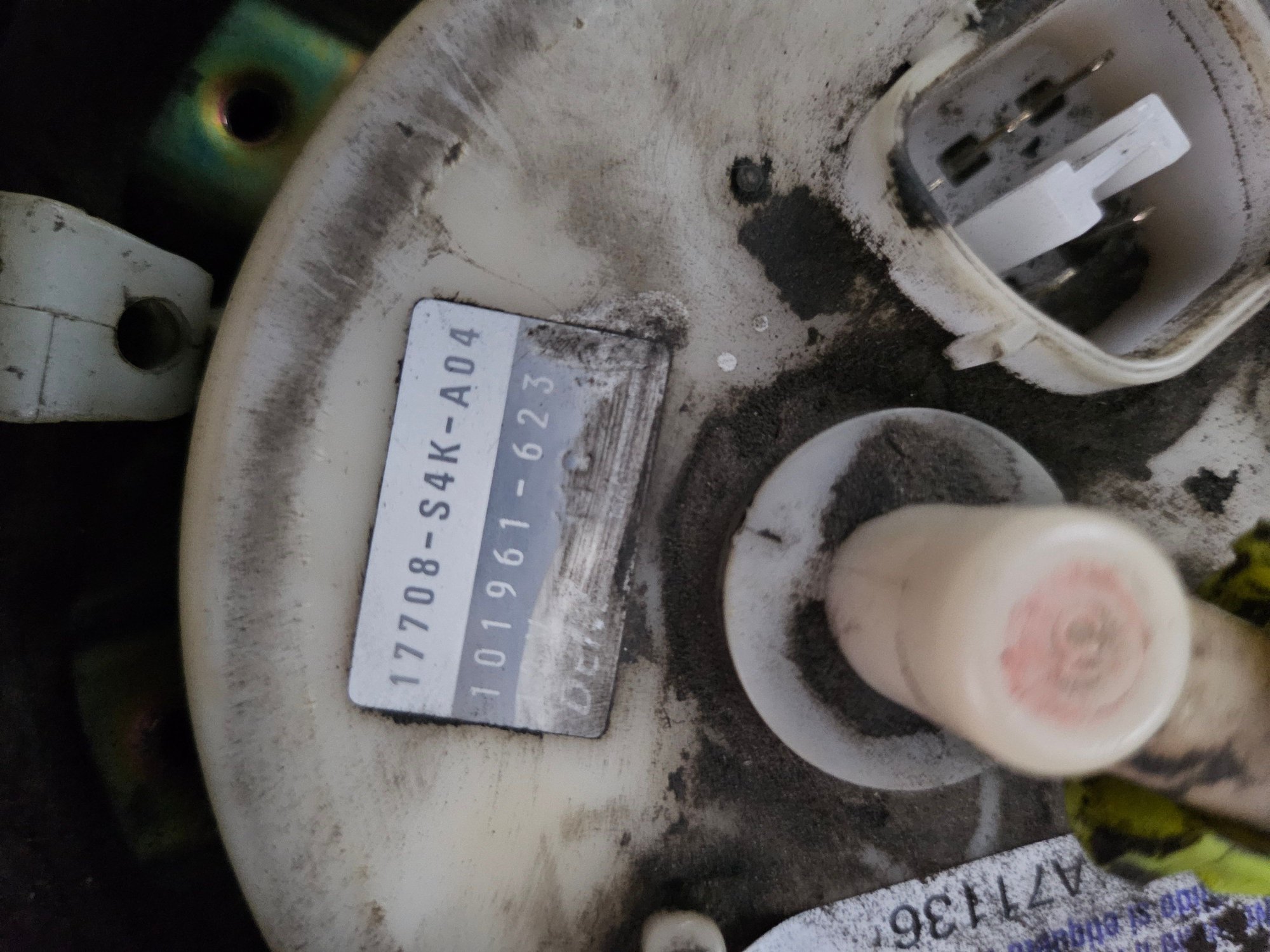

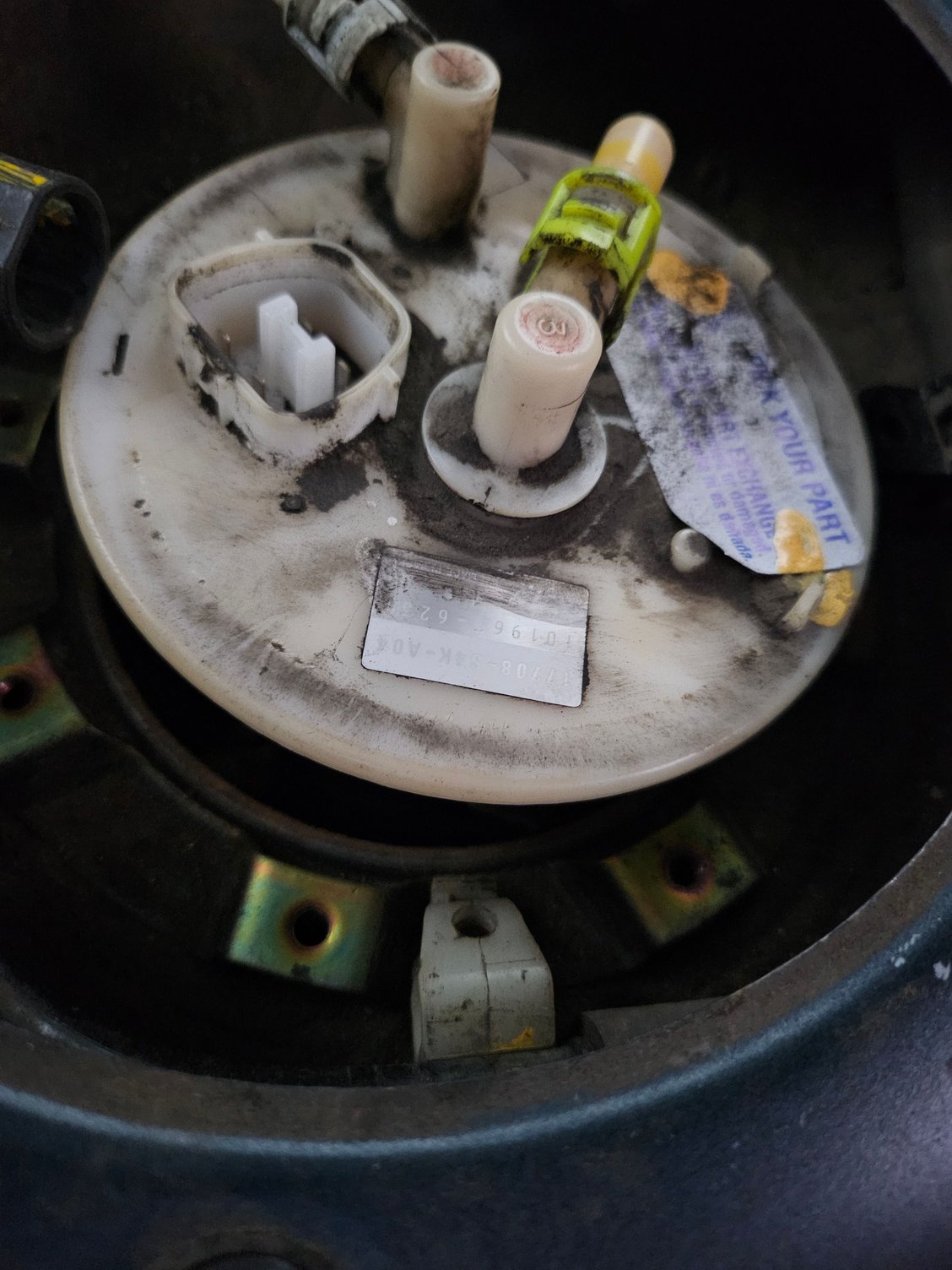

So I went to the pick a part this morning and pulled a fuel pump from a Japanese made car. I came home and tried to put it in but it still won't fit. Ok these are the tags on top of the fuel pumps. The one ending in 03 is the one from my car. The other ending in 04 is from the junk yard car. What ever heck?
