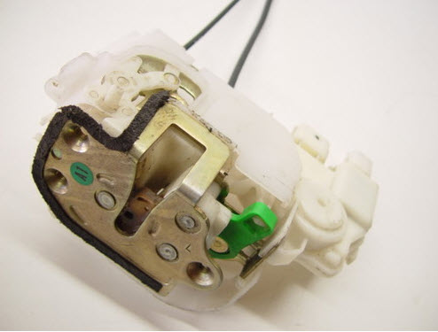

Old Jun 30, 2013 | 06:51 PM
You'll probably have to try to reach in to the latch to manually move the latch levers.
The first picture is the parts diagram for your car, showing the latch separate from the actuator.
The second picture is of a sedan (4-door) rear-door latch. Slightly different than the coupe; but, so you can see the levers.
Attached Thumbnails Door won't open on 2006 coupe to repair the broken cable.  Help!!-door-lock.jpg   Door won't open on 2006 coupe to repair the broken cable.  Help!!-03-07-accord-rear-latch.jpg
