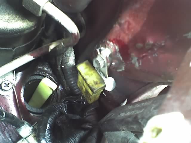

Ok, so I finally had some time to figure this problem out. After reading the wiring diagram, I traced the signal wires. What I found was a loose/dirty ground bracket. It appears that my car was previously in an accident and someone tried to weld the area back together but left the conection loose. So I cleaned it, and tightened it back up, and problem solved! So if anyone else experiances this problem, I suggest looking there first. The bracket is located on the driverside next to the windshield washer fill tube.Name:  05-21-08_1337.jpg
