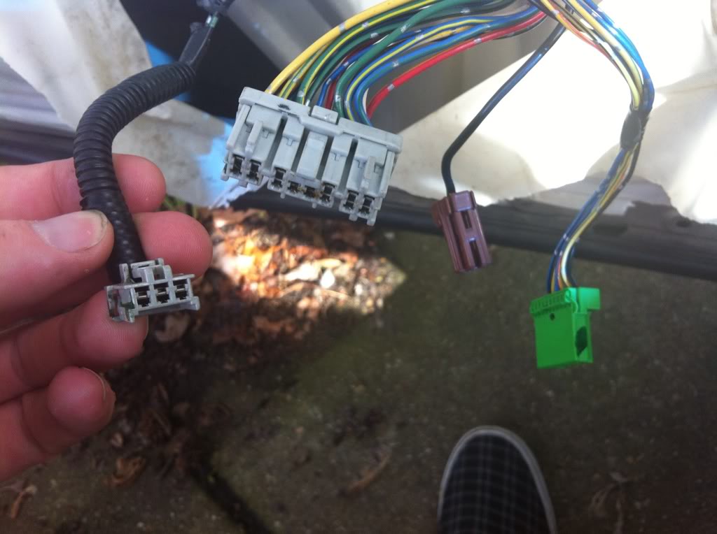

Ok so power windows. My buddy has a 91 cb7 it's a japan model. Took his door panel with master switch and plugged it into my door and the windows didn't work. Checked fuses in the box under the hood and I have 12 volts at all four positions. Go under the dash and pull the 10 amp fuse for the windows and nothing. But I dunno if that's supposed to be on all the time or a variable. Does anyone know. Any ways. Pulled the door panel off and checked the one plug to master switch its grounded. And I have 12 volts at four pins on the plug for the window switch. And I took the switch apart loosely. Got some
Resistance and changes when I operate switches. Any ideas

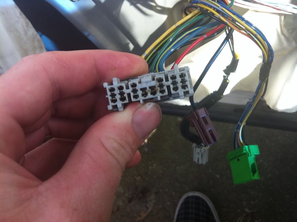

None of the windows work at all. At the master switch or at the individual doors. Under the hood I took a volt meter to the four fuses widows and have 12 volts across the terminals. Then in the box at the drivers side under dash there is a 10 amp fuse for power windows there was no voltage here. But I don't know if there should be. Looki g at schematics there is another relay in the box in the drivers side user dash????? But the four wires that should have voltage at the plug at the drivers door do have 12 volts umm greenblack blueblack yellowblack whiteyellow at the plug. But there is the connection for the window regulator the 2 to the master switch and one to the power mirrors and then this plug just hanging out going to nothing with 3 wires green greenred and black. I tried to jump the hot wires at the window switch plug to other pins and nothing happened. If that helps.
First picture is the window plug with the lock out plug next to it. Yes this was plugged into the master switch and the second is the plug that was not plugged into anything.
