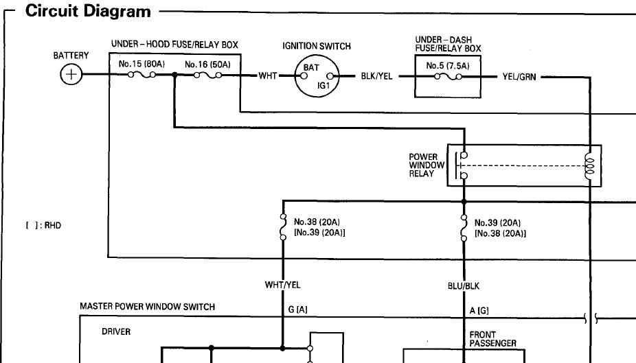

Sounds like a relay issue of some sorts..... So you can switch your cooling fan realy in place of the window relay and test again. If that doesn't work then we'll have to do some more tests.
Attached Thumbnails electrical problem with intrument cluster-4th-gen-power-window-relay.jpg

Well. I tried swapping it with the cooling fan relay. I even tried the relays out of my buddy's car that I stole the master switch and all from that works perfectly fine.

Can we go back to the pic of the relay I posted.
With the relay out, test the connections with the key on.
2 of them should have 12v to ground.
1 of them sould have continuity to ground.
Do they?

i dont know about the VSS but the fuse under the dash the one 10 amp fuse that had no voltage with the key on i believe is the power to the relay with the key on. i know that i had 12 volts at two spots and then a ground yes but i also have 12 volts at the plug in the door so. somwthing is not coming on with the ignition to give power to the windows. and i hope the jumper doesnt burn out the master switch. i had an extra from the junk yard and yesterday the back passenger window wouldnt come up. would go down more but never came up. so ???? i haven had a chance to look anymore at the diagrams etc and i tried cleaning all the ground boxes i could find. including the one on the thermostat housing. imma make a video here soon on what i found and all. was looking at your diagram and fuse number 5 the 7.5 amp comes off the ignition switch and should be what starts the relay so you can use your power windows. when i get home imma take a look at that and see what condition it is in.
