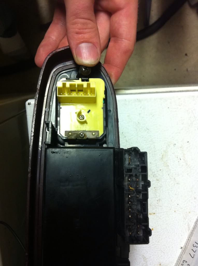

There is no where for the three pin Plug to go on the master switch. and then this plug just hanging out going to nothing with 3 wires green greenred and black.

Here is a bad pic of the master. It has the main plug and the one wore plug for the lock out and there is the power window plug. Name:  4e8439a5.jpg

Yes the wires where the door "bends" can get broken......Look at the wires the the window switch...
See if you have a WHT/YEL, BLU/BLK, YEL/BLK AND GRN/BLK .... These should have 12v to ground with the KO -key on......do they?

Yes I do have 12 volts to ground at those four wires. I also tried to use some wire to jump across the plug from 12 volts to motor to ground on the plug and couldn't get any thing to work.
