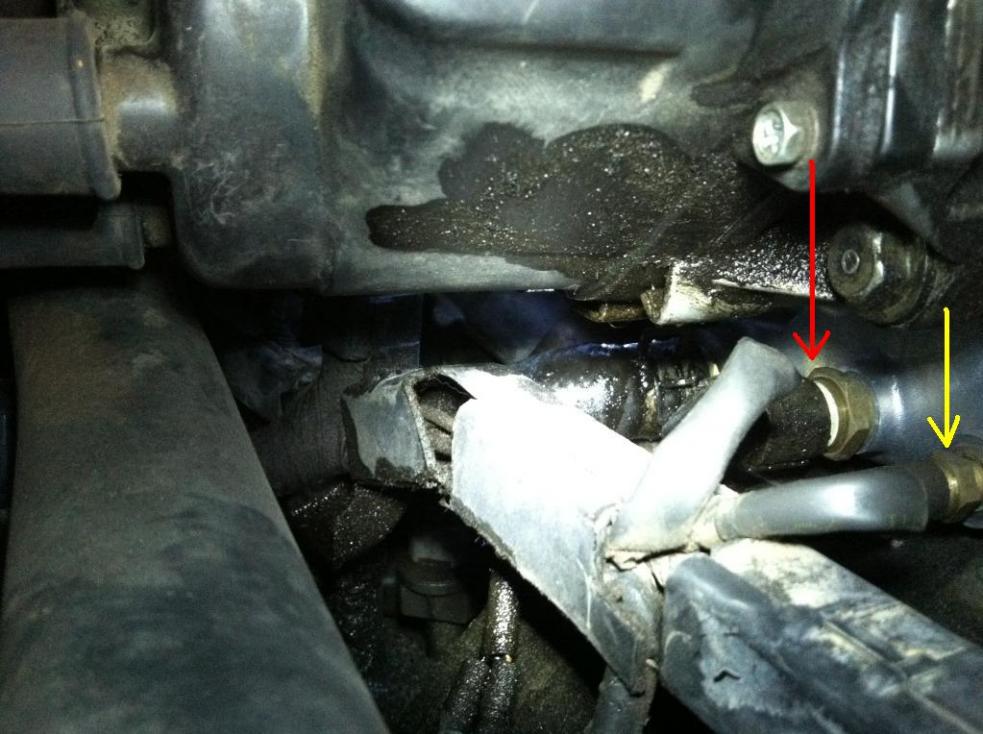

Old Dec 19, 2012 | 06:27 PM
If the ECT was replaced and you are still getting a code then more testing should be done...be sure the wires are good all the way back to the ECM.....also please ref pic, red arrow is the ECT......as stated under the dist on the pass end of the head. EDIT: I know the pic is for a 5th gen but the 4th is in the same place.
If you are smelling exhaust fumes, need to find/fix/repair the leak. Depending on where the leak is, this can cause issues.
