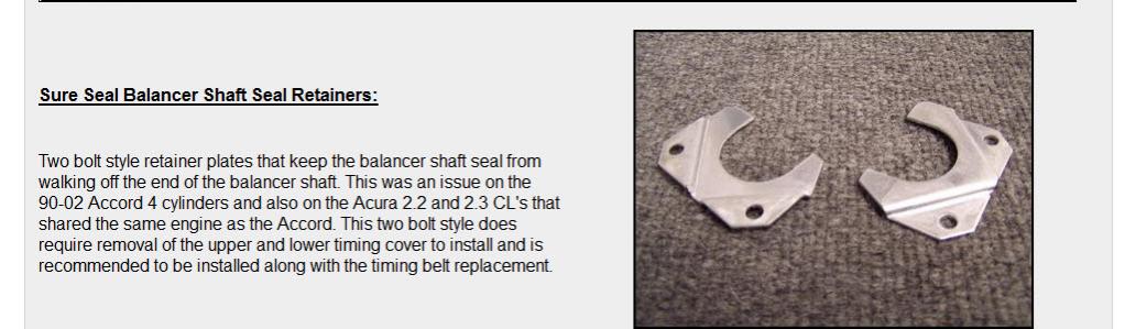

Too late. I just got home from the dealer (Darrell Waltrip Honda, Franklin, TN), and I don't think he gave me the right part. I paid a total of $21.56 for the new crankshaft seal and this balance shaft retainer. I questioned him on the retainer since it doesn't look anything like the one in the TSB, and Mr. "Cam" Jones got a little huffy, said this was the only possible one, and rushed me out.
This would be a good time to rant about why I avoid dealerships like the damn plague...but I won't.
Will this part work, and why is it $6.95 before tax?!! Didn't even come in a bag, and there's no P/N for it on the ticket, either.

That may be the right part, it just may be installed slightly different. I remember on another Honda board someone telling me about the different part number years ago. Your engine is a F23, the earlier generation were F22.
Can you post the Honda part number?
Edit: I just realized you said there was no part number (p/n) on the ticket. I'll see if I can find anything; but, take a look by holding it next to the balancer shaft seal and it may make sense.

That retainer isn't right. It should look like this:

That is a F23 engine. So, it is a different retainer than what the OP got. I've seen the other one on the internet though too. Hmm..on the other retainer.

It may work, as I found similar style to that on the internet, see attached pics. It may be a revised part.

Well, maybe I was a little hasty, then. I'll take a look at it tomorrow morning and see how it fits. Looking at Roader's photo, I guess those two bolts right over the balance shaft might fit the holes on this thing.
$6.95 is about $6 too much for this part, though, by the feel of it.

If it fits then it's a better design. The one in the pic - and the one on my F23 - interferes a bit with the lower cover in that the lower cover doesn't sit flat over the installed retainer.
