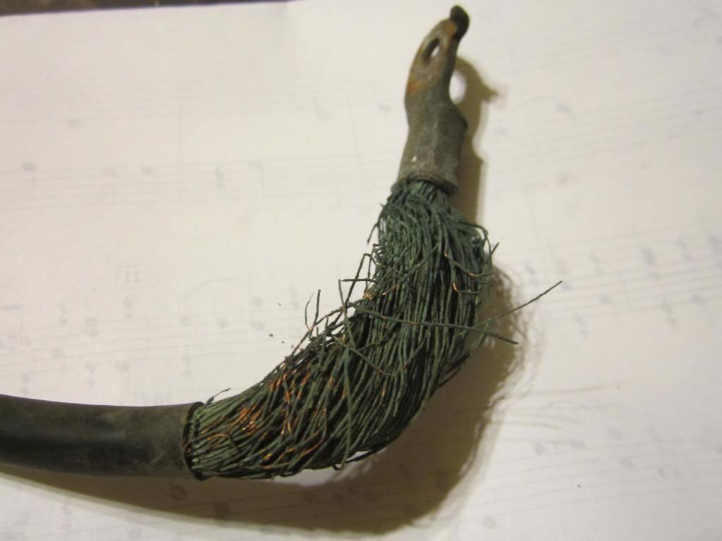

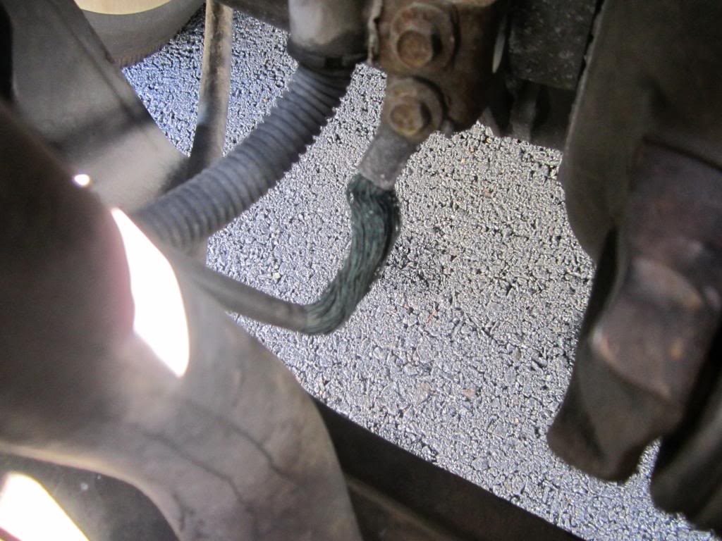

oh, and here is that wire i was talking about. It looks a little green to me but i guess if it cranks its ok. The starter sounds a little "slow" to me compared to some other cars but i guess you guys did not think so.

Old Nov 6, 2012 | 03:12 PM
  #34
shipo's Avatar
Joined: Aug 2012
Posts: 3,070
From: Southern New Hampshire
That (ground?) wire looks a bit sketchy to me; I'd replace it for sure.

Posts: 113
Here is a better picture.
yeah, i think it needs replacement, i will see if it cranks faster when i replace it tomorrow. But i guess the problem is not the temp sensor, right?
