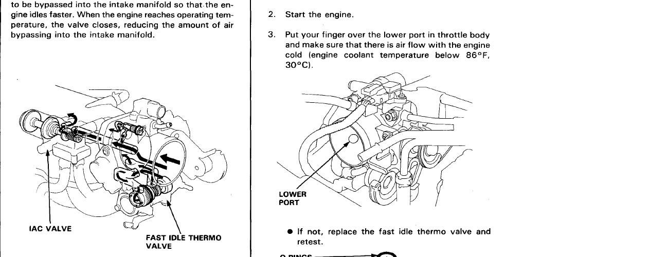

Yes lower port....something like the attached . If nothing else a good description of the air flow thru the TB, including both the FITV and IACV.
EDIT: And to add a bit. Never adjusted the FITV on my 5th gen, done a few of my 3rds. When/if you tighten the "ball", it should be "snug". If you go too far then you will get a bounce in the idle just as the FITV should close....as it closes too early and the IACV tries to adjust. Be sure as well that the o-ring on the cover of the fitv is sealing all the way.

yep, thats what i did, i took it apart and cleaned all the pieces and put it back together.
The "ball" is tightened snugly and all the orings were cleaned and look good. Even after reinstall it idles fine, but there is constant suction at the fitv port even after getting to operating temp.
