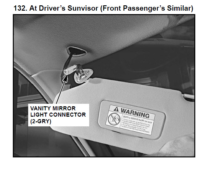

An area of a possible short is the wire connector for the sunvisor vanity mirror. It could be caused by a loose connector cover on the wire to one of the sunvisor vanity mirrors. To check it, remove the sunvisor, and look at the end of the RED/BLK vanity mirror wire.
I have a similar issue. I have a 2000 Accord EX-R and the passenger side vanity lights worked no problem but the driver's side did not. So I thought it was an issue with just the driver's side visor/vanity. So the next day I went to troubleshoot and the driver's side started working when I flipped the mirror cover up, but I noticed that if I moved it slightly the lights would go out or flicker. So when I flipped the cover as open as it would go, the lights stayed on. So today I went and replaced all 4 bulbs with LEDs and after a couple tests of flipping up the driver's side mirror cover, the lights stopped working on BOTH visors. They flickered at first and now both sides are out. I replaced the LEDs with the originals (all were working before), and not both vanity lights on the driver and passenger side do not work. I also disconnected the driver's side mirror from the roof and the plug looks fine. What could be the problem?

Sounds like there was/is a loose connection in the light - you stated the "flickered" at certain points. At one of those points, I'd bet that is when it blew the fuse.
Keep an eye on it and if it acts up again you might have to dig deeper into the wires to see if one has a "rub" or something causing it to short out.
