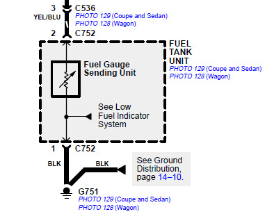

This is really the only thing I could find but not sure if it has anything to do with the fuel pump.

Old Jan 24, 2013 | 08:10 PM
Posts: 7,101
Both the fuel gauge sending unit and the fuel pump share the same ground at location G751.
So if this ground was loose and really dirty it would cause the car to not start correct?
Old Jan 24, 2013 | 09:16 PM
Posts: 7,101
The location of ground G751 is usually protected from the elements; but, you can take a look.
