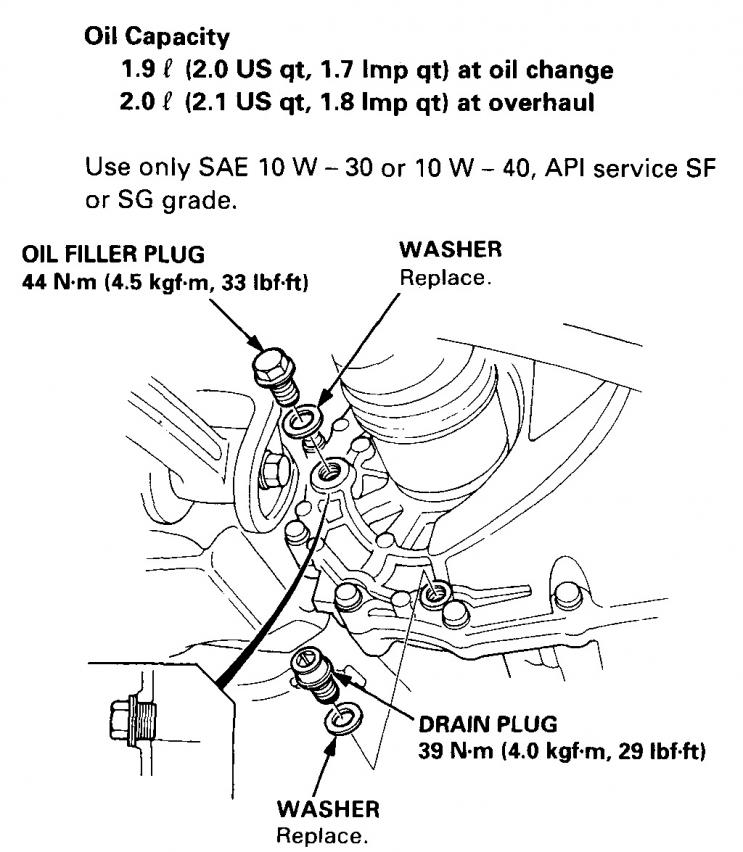

I saw your signature, its a 96 EX MT.
Its pretty simple to change the transmission fluid. You can download a 94 shop manual from the spooner link I posted in the online manuals thread in the DIY section. See attached pic from that manual.
Jack up your car, then put it on jack stands.
There is a drain bolt on the bottom of the transmission that has a square hole that you can put you ratchet into. Remove the top fill plug first, then remove the bottom, allow all of the fluid to drain. Put drain plug back in.
I used a funnel with a hose on the bottom and filled the transmission from the top of the car. I had to route the hose to the hole where the fill plug was, added the fluid, tightened the fill plug. Your transmission takes 2 quarts of fluid. I would get the Honda MTF fluid from the dealership. You can use the grade of oil in the pic as well.
