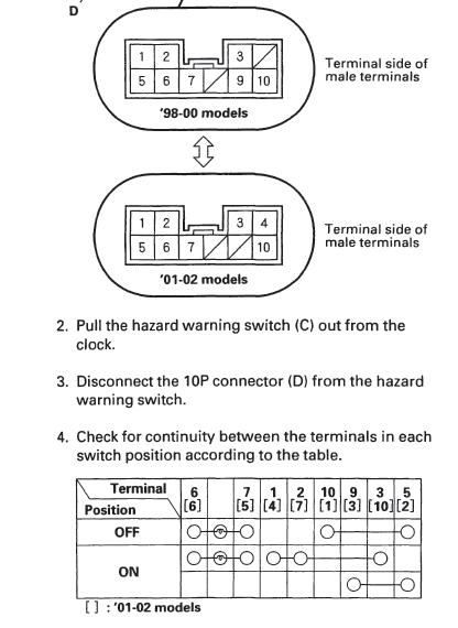

Did the lights act up the first time you drove the car?
Can you pull the hazard switch and test it?
Attached Thumbnails Help!!! No Lights!!!- [Solved]-6th-gen-hazard-switch-test.jpg

You have some basic electrical tests before you jump to the multi-plex control unit.
Checking fuses is very quick with a volt meter or even a test light. I linked a good video below on how ericthecarguy tests fuses.
Along with poorman's test of the hazard switch, check the wht/grn and the yel/red wires that plug into the hazard switch. Both should have 12V to ground with the key in the II position.
