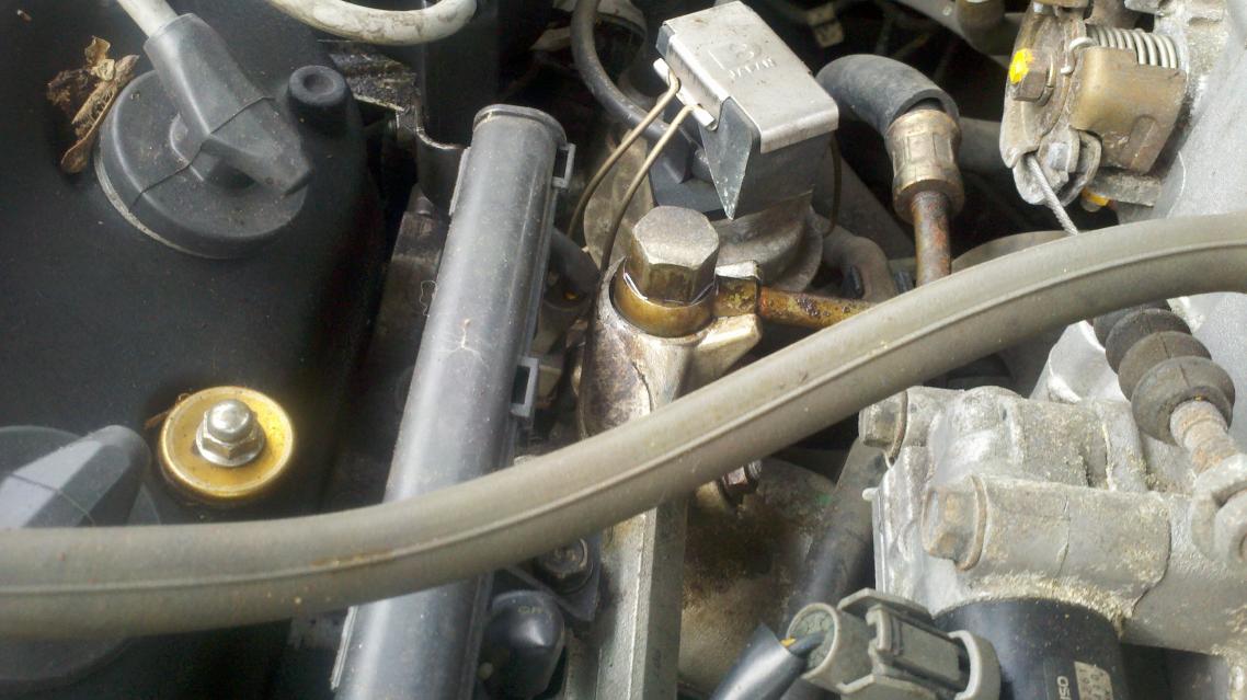

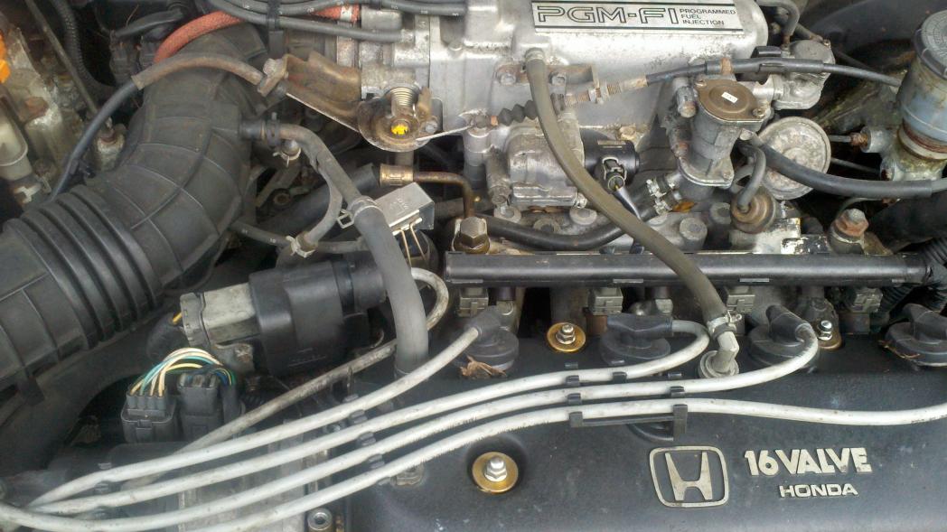

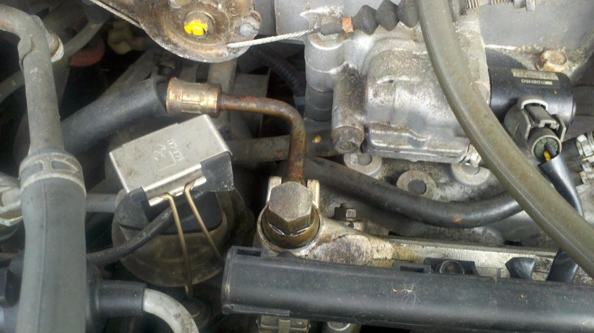

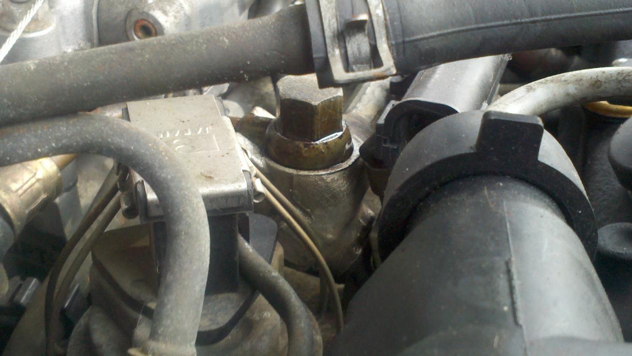

I just got my 92 EX Sedan back on the road. I've been driving it daily for 3 days now. On the second day I noticed a hesitation/bobble on throttle, when accelerating from a dead stop. I looked around under the hood, and noticed this part was damp. I touched the fluid, sniffed and determined it was fuel. There seems to be no spraying, or pouring of fuel out of this part, but just enough to wet whatever part it is. I have attached pix of what I believe is my problem. It is the 'golden' colored piece right behind the fuel rail. I figure it has enough of an escape of fuel to allow injector pressures to lower and cause my hesitation. It is the size of a 17mm socket. If anyone can identify this part for me, and give some advice on how to remedy this, I would appreciate it. Thanks ahead of time.

That is the "banjo" fitting for the fuel rail. Could be loose, could be the sealing washers are "gone". Suggest getting new crush washers and see if that resolves the issue.

Thanks for your help. I tightened it, and it made the seepage, into a stream. So I figure the seal is gone, and needs replaced. I will just replace the entire bolt since new bolts come with the seal at the local parts place for $3. Hopefully that will take care of the problem.
I've never worked on the fuel system, but I'm assuming that there won't be much fuel loss since the pump won't have power to provide pressure. Is there anything that I need to be particulary aware of when installing the new pieces? It almost seems too simple of a solution.

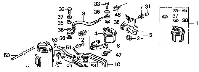

Well that is what I get for going on memory....looks like there are three washers.... Sorry
#35 is some sort of spacer nut under the banjo bolt
