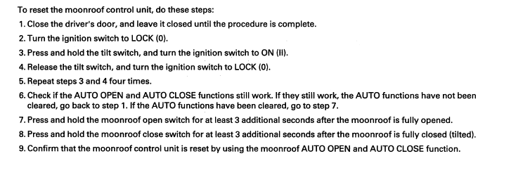

Dear Forum Members I would need your kind support please if you can. I replaced a headliner and had to remove the sunroof glass and after putting everything back, sunroof won't open nor tilt at all. There is no even motor sound even though I plugged all wire connections back. It's pain in the butt to remove everything back again. Customer will come back after few days as I promised, I will fix it. Is there any way to reset or something?

I only have a shop manual through the 2010 accord. There is a moonroof reset procedure on the 08-10, so I suspect the 2012 has one too.
Here is the 2010 procedure and may be worth a shot.
