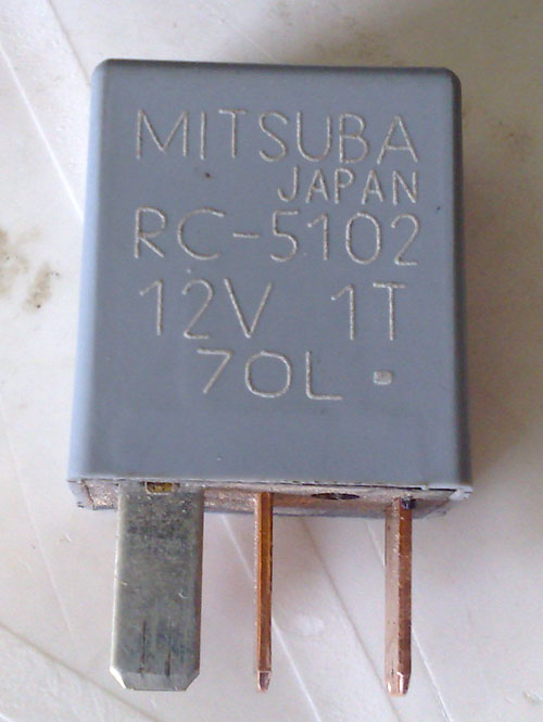

good news, I finally found the problem, well what seems to be the problem.
Under the dash, behind the fuse box there are some relays, for the sunroof we have 2 gray 12V 1T MITSUBA RC-5105 relay, they control the voltage send to the sunroof motor. It seems that one fo these is defective, I change one with the other and then the sunroof activates different parts of the circuit, ones that were dead. Any ways, I still need to buy a replacment to confirm, but I'm pretty sure that's the problem.
attach is a picture of the little demon.

WheelBrokerAng,
Do you mean that the one you found should be the one for the Sunroof?
if that is what you meant, let me tell you that I have made tests on those relays I said on my post, the picture I post is the actual picture of my defective relay.
Please correct me if I'm confuse. (english is not my natural language)
a note:
the picture you post looks lika relay for a 5th gen accord, I found one when searching on a local car yard, mi Accord is a 6th gen i though they should be the same but i guess is not.

I think the relay part number stamped on there is RC5102 and not RC5105. Autzone sometimes uses generic pictures for their parts.
You can pick one up at a junkyard for pretty cheap. The dealership listed price is around $21 for a new one.
