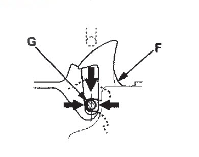

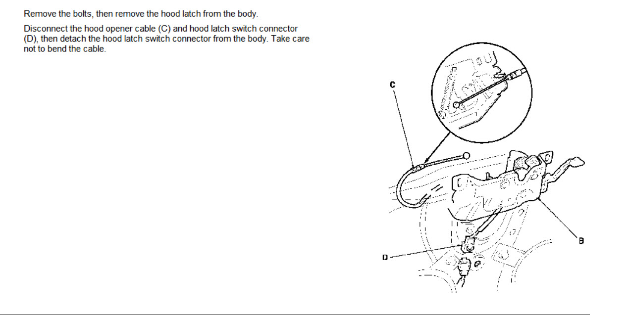

Is the hood damaged or the u-shaped striker on the hood bent? If not, try adjusting the latch first and greasing it before replacement.
I've attached the instructions for hood latch replacement. During replacement, latch needs to be centered.
Attached Thumbnails Hood Latch repair/replacment-hood-latch-replacement.jpg   Hood Latch repair/replacment-hood-latch-adjustment.jpg
