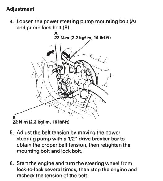

However, I could not locate the bolt that can adjust P.S. belt tension. According to the diagram, I can lossen #6 and #17 bolts so I can remove the old belt.
Would someone please let me know where that particular bolt is locate.
If it doesn't exist, how can I adjust belt tension.

A nice pry bar/breaker bar
Old Apr 16, 2013 | 05:18 PM
Kind of like this. Doesn't show the braker bar but you'll figure that out.....just be careful. You want just enough where the belt does not make noise....too tight and bearings get worn out.

Thank you
You are the man!
Look like I will need an assistant

Get creative.....I have the ps belt tension down to a science on my 3rd gens- same "pry bar" set up on the PS. I have a nice long pry bar, place it in there, gentle push with my right shoulder, tighten the lock bolt with my left hand....done, simple right
