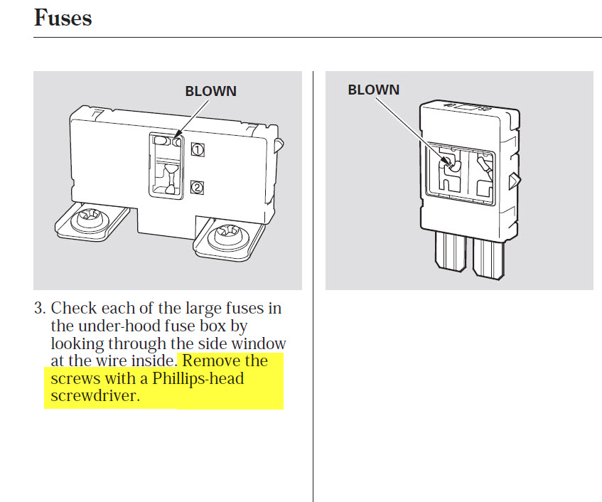

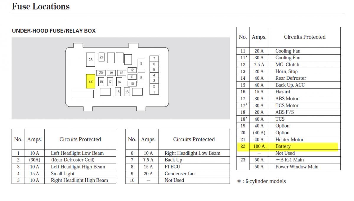

Check the "main" fuses, theses are the higher amp (~100 or so, #22???) and usually have a clear top, located in the under hood fuse panel.
Old Dec 13, 2011 | 06:39 PM
Agree with my friend Poorman212. Do not connect the new battery while attempting to replace fuse, you do not want to accidentally bridge the connections with a screwdriver.
See attached images from owner's manual.

turns out it was just the battery fuse we went to the local honda dealer and picked 1 up put it in and we were off haha thanks for the help guys especially redbull i never woulda looked for that 3 prong battery fuse if it wasnt for the pics u attached
