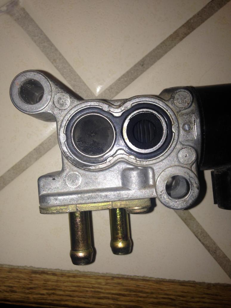

I did it. I took a small hammer and, with the little swinging space available, tapped at the bolt for a bit and that did the trick.
Pretty dirty!
I reset the ECU and the idle doesn't seem to have changed. The FITV tightening made a significant difference, however.
