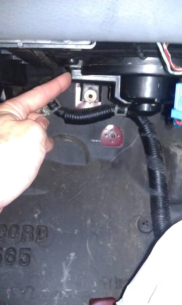

Update: I really appreciate all the help, guys. It rained a few days back and I was able to see where the leak was coming from. It appears to be from under/behind the glovebox, as indicated in the pic. Could this possibly be from the a/c drain tube?

I'd say that is either from the windshield or from the "fresh" air intake.....ac drain tube is to the left of your hand....maybe 4~5 inches. on this gen you can pull the blower pretty easy, might have to pull back the carpet for the added room to drop the motor, then kind of look up into the ac/heater box.
