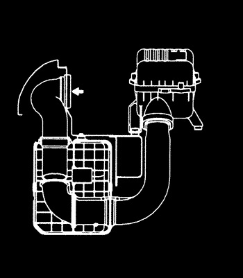

ORIGINAL: MY1stHonda*Accord*EX
what is the "intake resonator that is in your bumper"
An intake resonator is there to quiet the intake sound. But it's cooler when you accelerate from the sound it makes, so I removed it.

On the V6, it looks a little different, but it does the same thing. On the 6, it is inside the driver's side bumper in the corner. The filter box pulls its air from below ..... the resonator. The resonator then has a snorkel that pulls its air from behind the driver's side headlight. Without the resonator, the stock filter box pulls its air from the CAI location.
