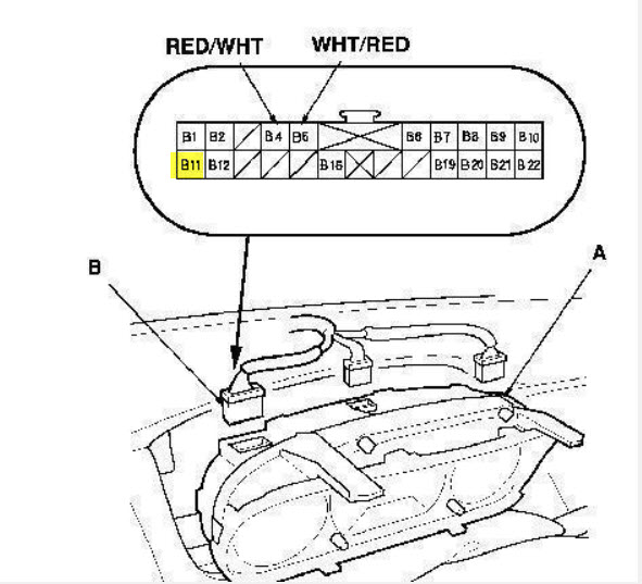

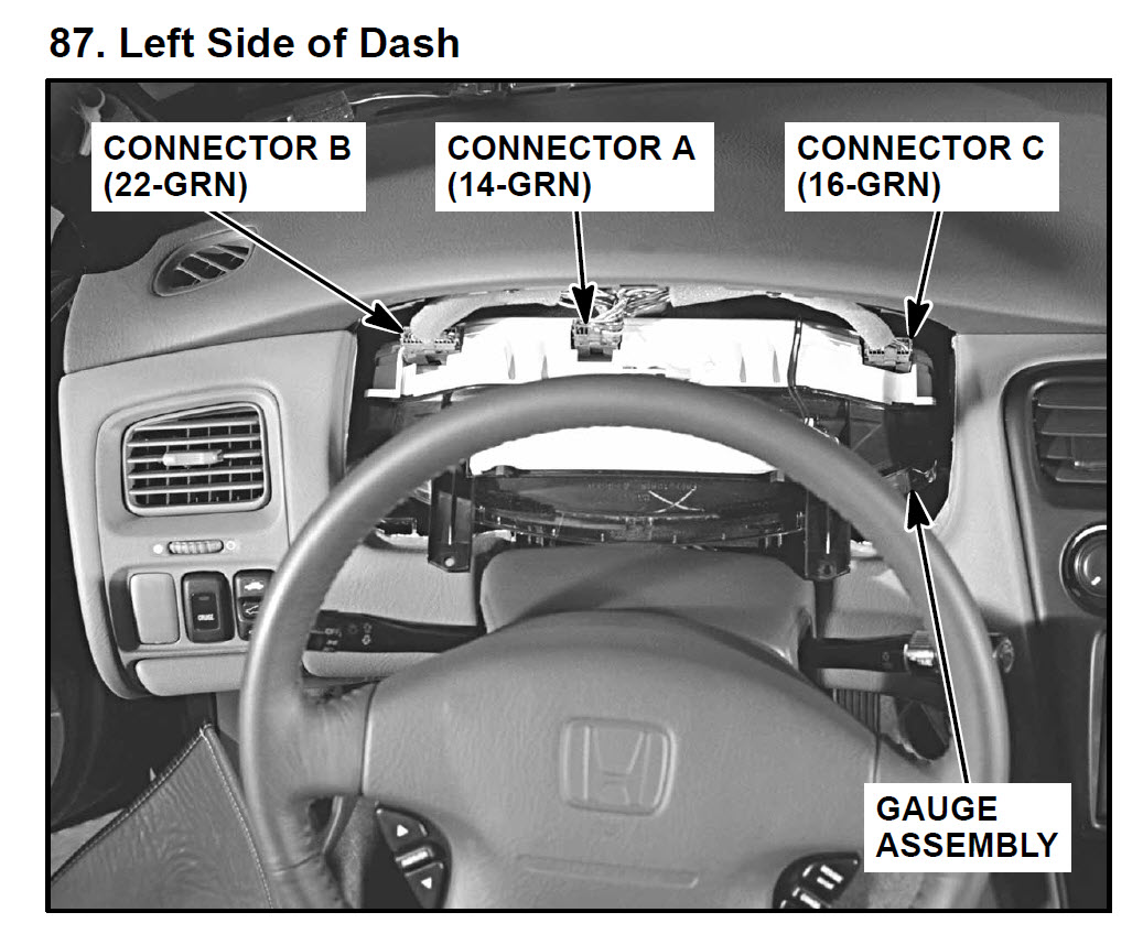

Measure the voltage at terminal B11 (terminal no. 11 at Connector B) with the ignition switch in ON or START.
Attached Thumbnails Instrument Panel Gauges Not Working, 1999 Accord-b11.jpg   Instrument Panel Gauges Not Working, 1999 Accord-gauges.jpg
