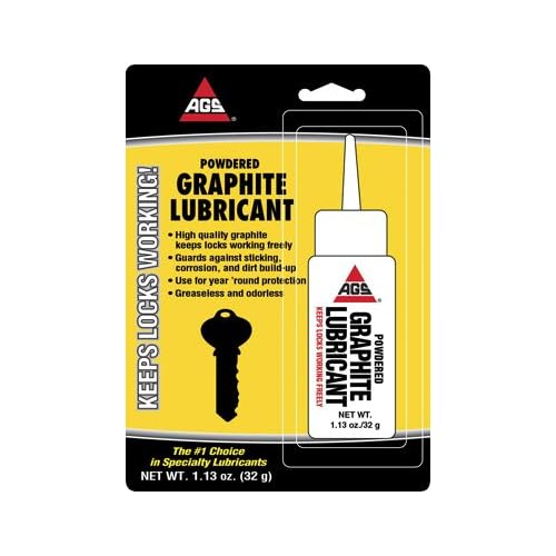

Graphite is the ONLY thing that should be sprayed into ANY lock.
Light oil will attract dirt and clog up the workings of a lock, do not use it.
Yes it may help at first but will cause worse problems down the road.
Old May 25, 2012 | 09:56 AM
crispin's Avatar
Joined: Sep 2010
Posts: 1,653
From: Tennessee
This is the stuff, buy it at any hardware store, less than $5.00

Yeah, Crispin is probably right, but dry graphite won't free a stuck mechanism.
I've seen graphite in a suspension in isopropanol. That should get it in to loosen up the pin, then the isopropanol evaporates leaving dry graphite behind.
