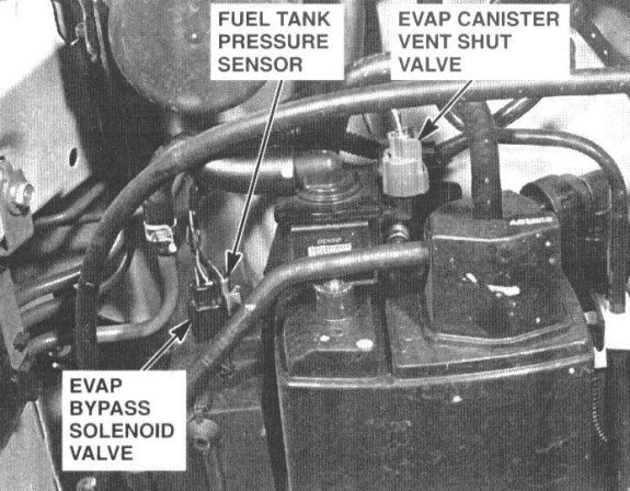

When you get the code pulled, if it's a P1457, suspect the EVAP bypass solenoid valve, common problem.
