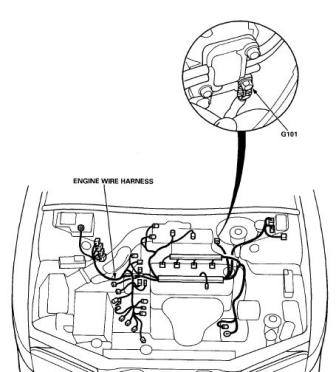

Clear the codes. Check the ground cable.....battery, then where it connects to the body and then where is conncets to the trans. Be sure all points of contact are clean and tight.
Then the main ground (G101) for the ECU is on the end of the, TB....same drill, clean and tight.
Check the oil level also.
Restart and see what you get.

So a bad ground could cause this weird hesitation at a certain RPM? I will be honest and upfront and tell you that the lead ground wire coming off the battery bolt onto the tranny is in horrific condition. It is frayed beyond belieft and only looks to be held in by less than half the wire itself on the bolt on the tranny.
