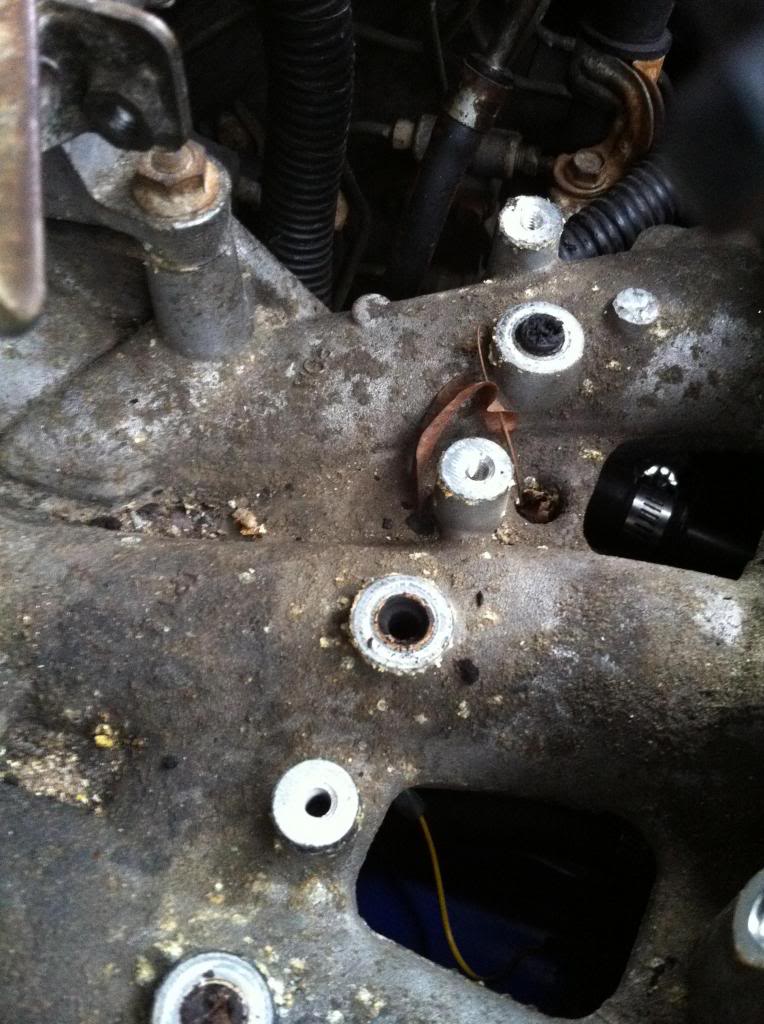

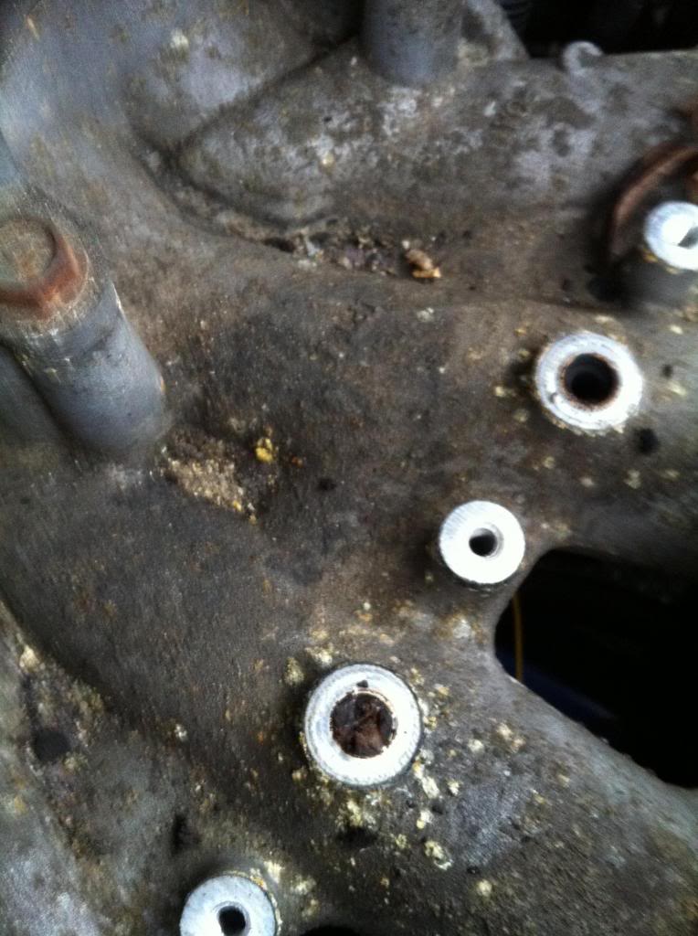

Update 11-27-2012
So today after the snow storm, I went out and took off the EGR plate. When I took the cover off the ports were really really clogged! I cleaned everything up really good and put it all back together. I started the car, the car idled awesome and then went for a test drive. The weird stuttering issue at 1400-2100 rpm is GONE! The car idles, throttles, and pulls at all rpm's awesomely!
Later tonight I will upload the pix of the clogged EGR ports for everyone to see. I hope this find helps others out when they are having a similar issue. Pretty excited that I have a completely functioning '94 Accord EX. Big success here in PA

This is the result of crossing my IAT with my IACV...
Also, here is how clogged my EGR ports were.
