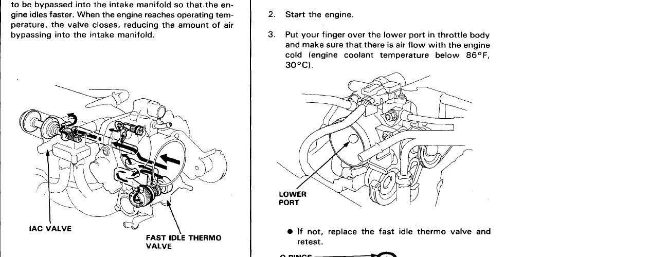

I did have 1 weird thing happen yesterday however. I started the car, and it idled fine. Then all of the sudden it started revving up and down, up and down. Then after a 45 seconds it idled normal and never did it again and didn't do it today. Could this be that coolant temp sensor you mentioned a while back which you suggested may be causing my cold start issue at random times.

Check the coolant level....air in the system can cause the idle to go up and down like that. If that checks out, might wait and see if it happens again. If so the FITV would be on the list for a good cleaning, there are some that will also adjust it but for now just check the coolant level.

Check the coolant level....air in the system can cause the idle to go up and down like that. If that checks out, might wait and see if it happens again. If so the FITV would be on the list for a good cleaning, there are some that will also adjust it but for now just check the coolant level...
Where exactly is my FITV?

And 3) To cgeromi, the fitv is located under the TB where the intake comes in, also congrats on the car and the journey!

Thanks for the B Day wish - I'm thinking of taking a long weekend for my B day,,,,can't decide if it is the weekend before or after. I'm thinking the Friday after...at least I can watch B-ball all day? Just wish the boy could be with me.
Anyway, as "firefighter" said, the FITV is the thing at the bottom of the inlet of the TB - 6 o'clock
