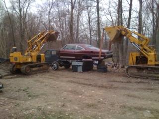

Poorman, this pic is for you! Another dozer use pic. This was taken about 2 years ago when we were unloading my friends 1957 Ford Galaxy 500. He ended up restoring her and selling it a while later.

When I was 15~16 a friend of mine had a ford almost just like that. It had a built sb motor that had to be pushing 400 hp. Yes where I grew up, we still would hang out in parking lots on weekends...me in the '66, jimmy had the '71 nova, nick in the '72 chevelle, sammy had a '72 camero, frank had the galixie 500

Thanks for the pic...that brought back some fun memories
