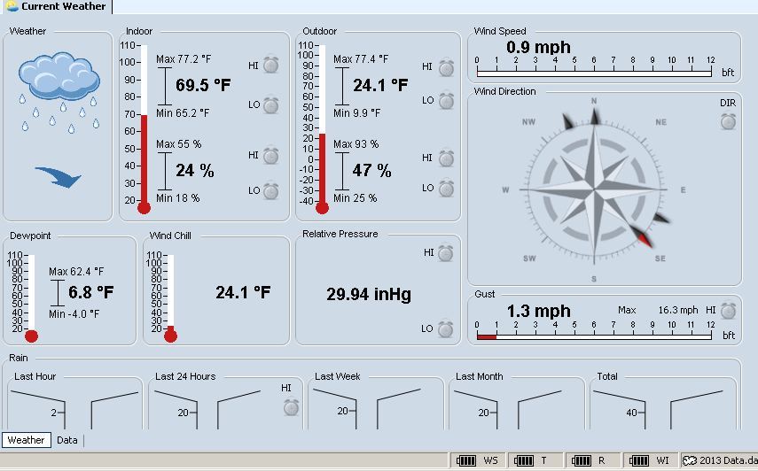

As for the blue smoke, it has not reared its ugly head since my last post, weeks ago. Lately when she's super cold, after sitting for a day or so though, it starts very rough. She cranks just fine but just won't fire right away. But after it starts it runs just fine. Then, I can turn the car right off, and it fires up super quickly. You mentioned the ECT sensor which I need to test tomorrow. It's just been too cold and windy here lately! It's about 24.1 here right now. Below is a screenshot of my personal weather station read outs. Brrrr!!
