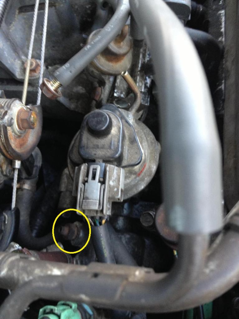

Circled the bleed bolt in yellow.
Thank you sir! I went and worked on the car today and found vacuum lines in the wrong place. We hooked those up correctly according to the diagram in this thread. Once the vacuum lines were hooked up correctly, the car didn't stall out and idled nicely. I also took apart the EGR system and cleaned that out (it wasn't really that dirty at all). I fired the car back up and the car throttled correctly the first time, but then after just warming up for a 30 seconds or so, the throttle began its low to medium throttle pressure hesitation and surging. I tried to pull the codes but I must have did it wrong, I am going to try again tomorrow. I am thinking at this point it could very well possibly be the TPS. I will follow up with more on Friday once I can try and pull the codes gain.
Thanks everyone for all the great information and advice. Hope everyone has a nice Thanksgiving!
