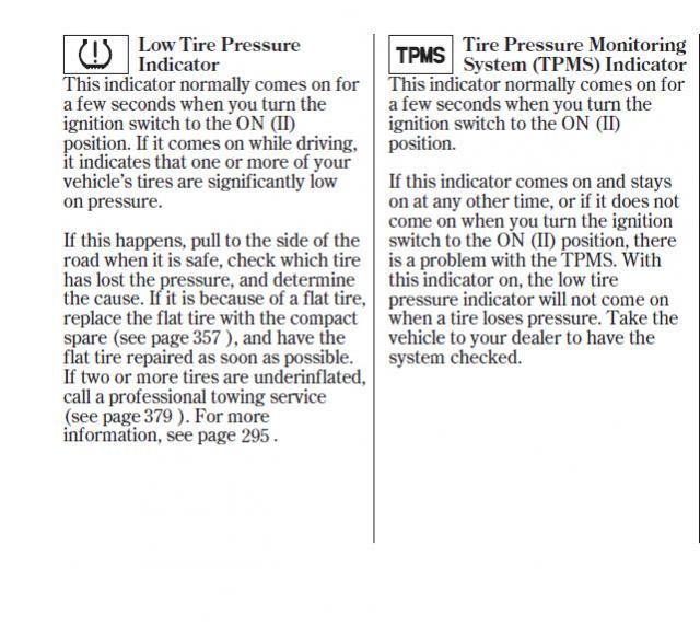

If it is the low tire pressure indicator, once the tire with the low pressure is filled back to the proper threshold, once you drive it, it should go out pretty quick. If not, check the tire pressures on all tires again. Tires generally should be checked cold. If this occurs frequently where you have to fill the tire every few days or weeks, you probably have an nail or screw somewhere.
If it is the TPMS light, that is something else.

Thanks redbull-1. You were spot on. You're getting too good at this I will certainly keep an eye on the tire though just in case it has been punctured.
