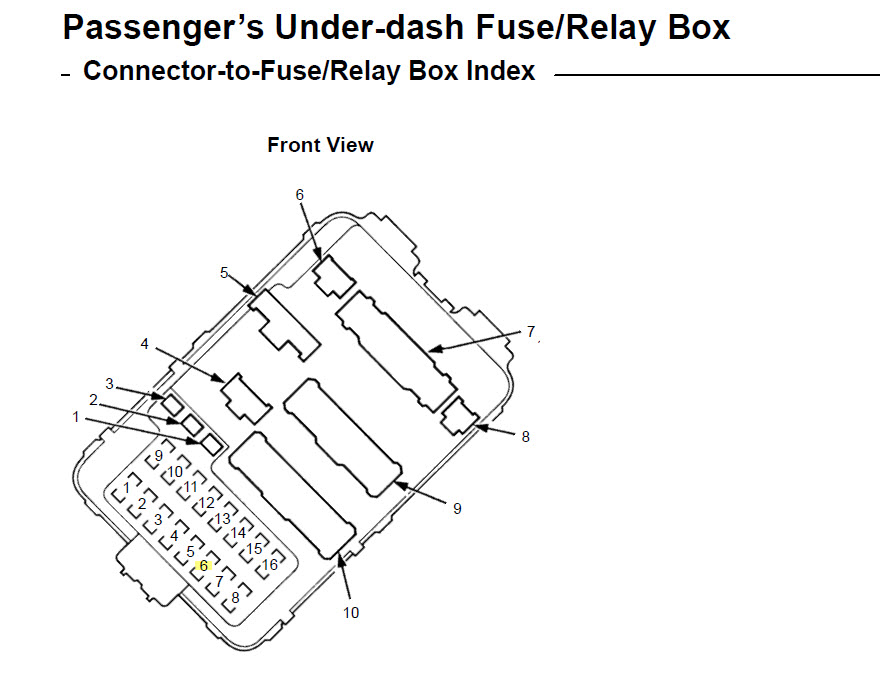

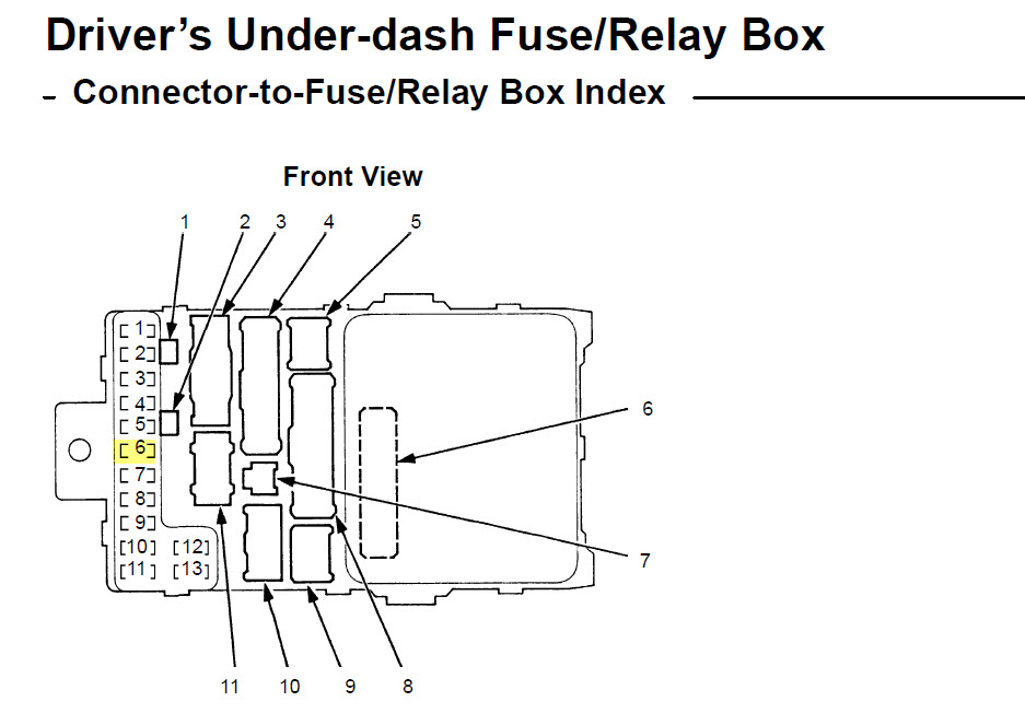

2. Check the following fuses:
  • Driver's side under-dash fuse no. 6 (15A).
  • Passenger's side under-dash fuse no. 6 (20A).
https://www.hondaaccordforum.com/for...-fuse-no-6-jpg
Most likely the air fuel ratio sensor needs replacement though. Without any diagnosis charge, it will probably be about 1/2 hour labor to replace along with the cost of the part.

thanks red bull. you indicated to check fuse no. 5 on the passenger's side but you highlighted no. 6 instead on the diagram. is it 5 or 6? i assume that the fix might only require those two new fuses as opposed to replacing the sensor?
They both should be no. 6; I corrected the above post. There is a lesser probability it is due to one of the fuses.
