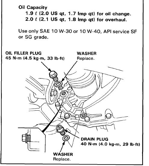

Yes, I know that I am loosening the fill bolt. It is the bolt to the upper left of the drain bolt. I think I am going to have to fill through the breather tube or backup sensor. Is that a good option? If so, which is better? I know the breather tube is better for me to get to.
Old Aug 15, 2013 | 08:13 PM
Remove the fill plug and "fill" thru it........
Attached Thumbnails Manual Transmission Fill Plug-4th-gen-manual-trans-drain-fill-plugs.jpg

That SOB is stuck like chuck and would not move. No matter what I did. So I just removed the backup light switch and filled it from there. I put two quarts in it. It was bone dry because I just replaced my tranny. Car is running now. Don't look like there are any problems. Cross my fingers.
