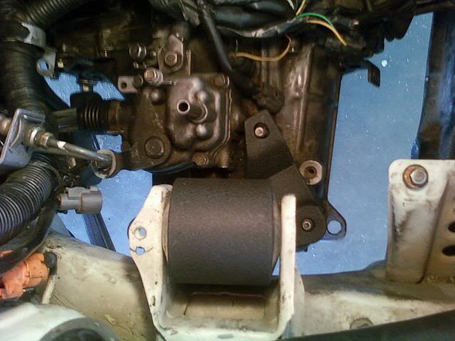

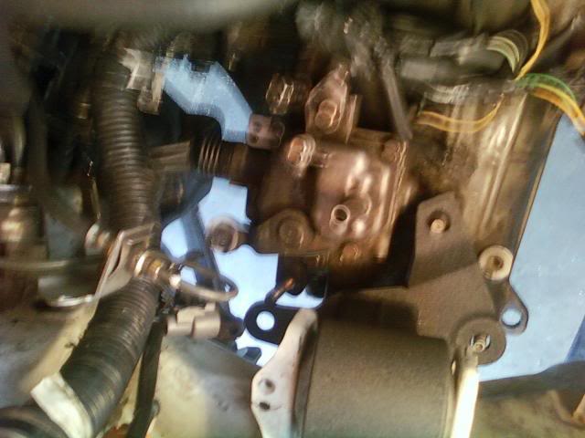

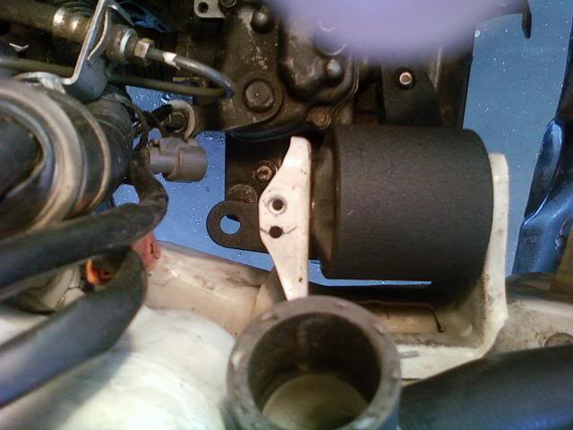

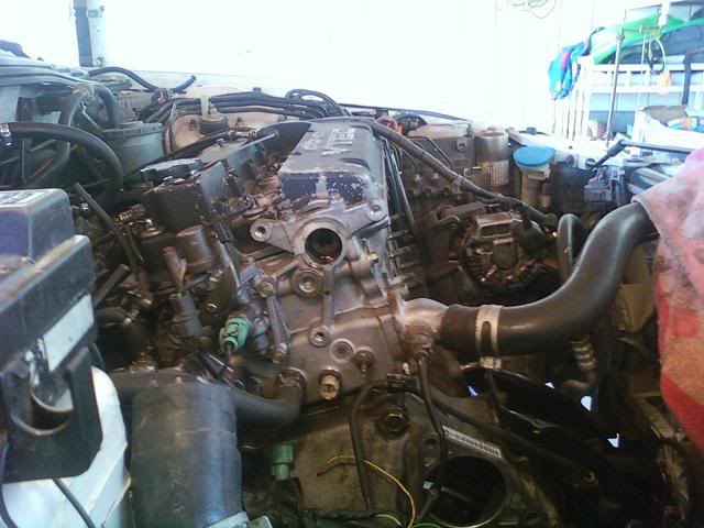

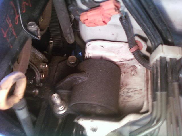

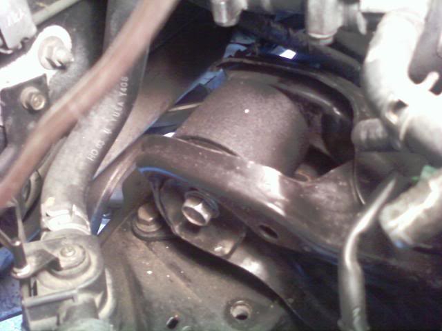

innovative mount set for the 94 accord with h22a swap.
It seems the rear mount from innovative isn't as tall as the OEM mount.
witch makes the engine sit like this \ \ instead of like this | | if your looking at it from the passenger side.
its making my transmission mount not line up correctly on the trans.
im wondering if anyone has had this problem or knows of anyone else having this problem?
it seems spacers may be needed in the rear or maybe because i have the accord bracket and not the prelude bracket.
any help would be awesome.
also the two bolt holes on the bottom of the rear bracket where the trans bolts to-had an issue with getting the trans in without hitting the bracket had to loosen all the mounts an beat on the bracket pretty good.
so i don't know im kinda lost.

Here are a couple pics

Looks to me like you should talk to a welder about fabbin' you up some adapter plates! I couldn't imagine it costing much. I think that would be way safer than "making it work"!
thats the thing they are "no hassle" mounts everything is supposed to line up... lol.doesn't seem that way though does it.im just trying to figure out if there is a specific bracket i need.

Oh! I see. Well, try checking with the mount manufacturer to be sure you have the right application/part combo. They should be haapy to help you figure it out.
