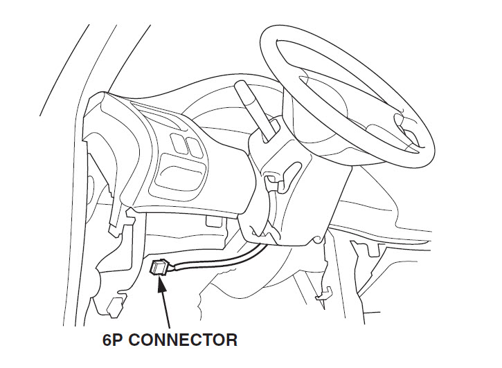

If there is a remote starter, it will be likely under the driver's side dash like PAhonda mentioned.
Although a remote starter may have many other wires, especially if it is also an alarm/remote starter combo, part of the remote starter wires would connect to the ignition switch harness wires. The remote starter wires could be spliced in anywhere along the path of the ignition switch harness (which runs from the ignition switch at the steering wheel to the driver's under-dash fuse box). The ignition switch harness connector at the driver's under-dash fuse box is a 6-P brown connector with the following wires:
  • White (always Hot battery power from under-hood Fuse No. 42)
  • Black/Yellow (IG1 power)
  • White/Black (ACC power)
  • Black/White (power (voltage) to starter cut relay and starter in START)
  • Yellow (IG2 power)
When looking under the driver's side dash, the issue can turn out to be due to a short (e.g. exposed wires touching) along the ignition switch harness wires.
You may have to remove the driver's under-dash cover to better see and access the wiring.
Attached Thumbnails My Car will not shut off PLEASE HELP-ignition-switch-wire-harness.jpg
