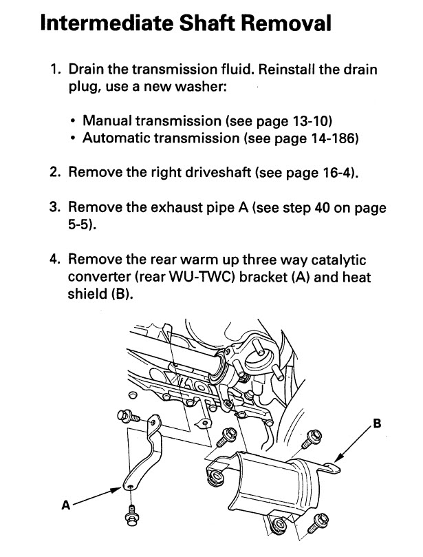

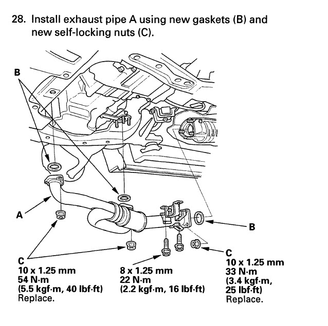

Old Nov 26, 2014 | 04:30 PM
Posts: 7,101
That's the heat shield for the intermediate shaft.
There are 3 bolts that hold the heat shield onto the intermediate shaft. But, the service manual shows Exhaust Pipe A (aka J-pipe) being removed first to access it. (See attached images.)
You may be able to use swivel sockets, etc. to get to the bolts without removing the J-pipe.
This other thread shows the drive shaft, intermediate shaft and shield removed. They make no mention of the need to remove the J-pipe.

Old Nov 26, 2014 | 08:54 PM
Posts: 7,101
If you jack up the car and safely support the car with jack stands, you can take a look to see if the three bolts that hold the shield are accessible without removing anything else.
6-point sockets have less chance of rounding the bolt head compared to 12-point sockets. Swivel sockets or swivel adapters or crows-feet wrenches might do the job if there is some space.
Old Nov 26, 2014 | 09:15 PM
Posts: 7,101
Another option that may work, is if you use a metal tightening/mounting strap around the old heat shield to try to stop it from rattling.
