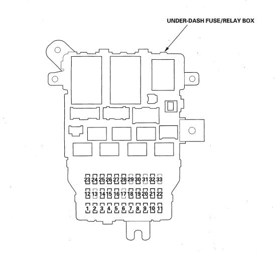

I blew the fuses on my interior upperhead light and for my radio. Can someone tell me which fuses they are so i can replace them or give me a diagram? (Lost my owners manual)
Its a 03 Honda Accord LX Sedan

Old Dec 29, 2012 | 09:57 AM
Under dash fuse box. There are three rows of fuses. Bottom row, 5th fuse (left to right) should be a 10amp fuse. Pull it and inspect it.
I do have a pic - didn't think I did
This is for the radio....I'll have to look into the other "light"
EDIT: Also check fuse #32 - 7.5 amp.

The 7.5 amp fuse was the problem. Replaced it and the radio worked once again. Thanks.
