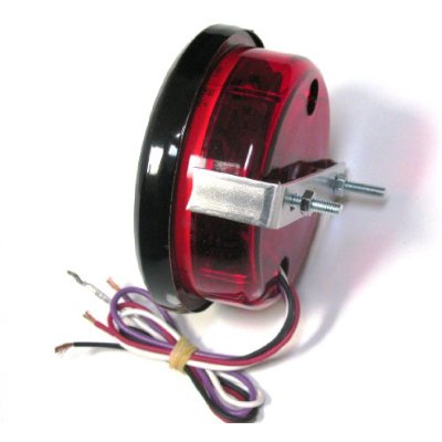

So my question is being that the instrument cluster works off of the 4 screws that send electricity into the speed cluster(speedometer/odometer) would i be able to put in a digital speedometer in the place of that and if so would it instal the same way as the original i have pictures and a haynes repair manual to work this project

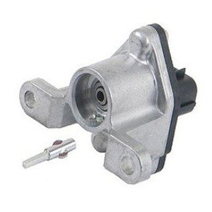

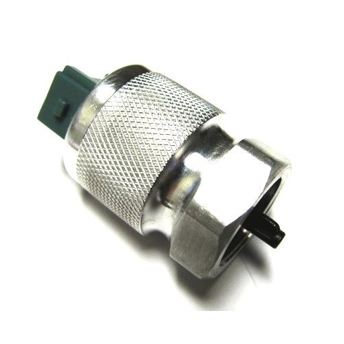

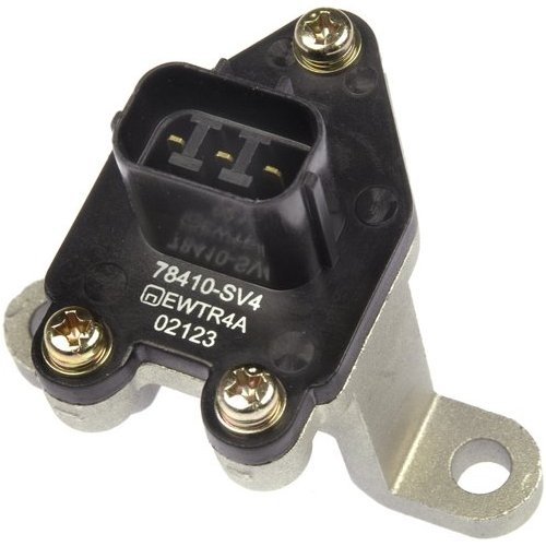

I have installed a new speed sensor for good measure im using pictures i found my cam is broke for taking pictures of my own.
Would i use the sending unit in place of the speed sensor for the "new" digital speedometer to plug into or would the digital speedometer "fit" into the same place as the original "old" speedometer, this would be the cheapest way to go to fix this issue because we all know how much it would cost if i have Honda fix it i have cash put away for this but bot all of it needs to go to just this any and all help will be appreciated on this i am basing these questions off of the parts of INTELLITRONIX SENDING UNITS and INTELLITRONIX LED DIGITAL SPEEDOMETER i hope this all helps
