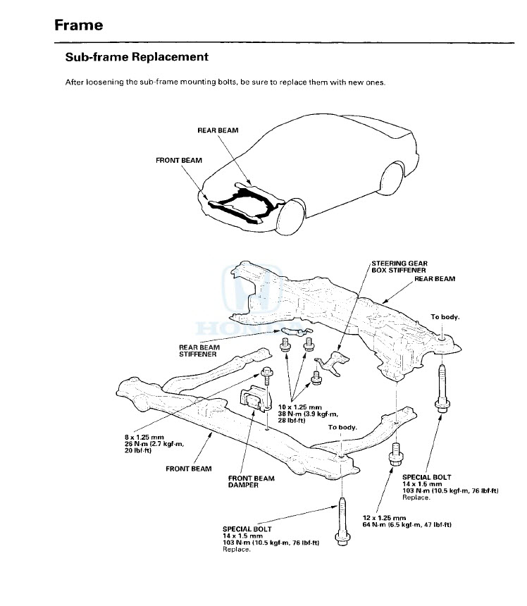

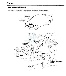

The front subframe principally consist of a front beam and a rear beam.
They are not the same thing as a front lower crossmember, which is part of the front bulkhead (which also is not the subframe). However, typically, part of the front bulkhead does also get damaged in a collision, etc.
I don't know if those are different for 2-door vs. 4-door. Automatic vs. Manual. V6 vs 4-cyl... etc.
Go to an online parts place like Majestic.
www(dot)hondaautomotiveparts(dot)com
Put in all your car's information.
Select "Body/Air Conditioning"
Select "Rear Beam / Cross Beam"
With the actual Honda part numbers, you don't care what name they use.
(for some reason Honda puts front & rear together on the same drawing, & they use the term "cross beam" for the corresponding frame at the rear suspension)
