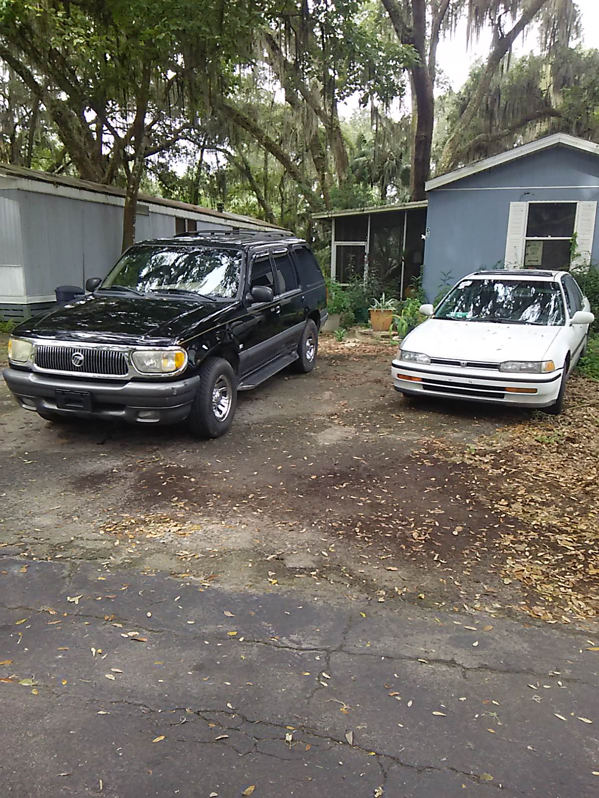

Don't worry about answering that question, I've got another vehicle I'll be picking up tomorrow and am seriously considering taking this to the junkyard.
Old Sep 16, 2015 | 11:17 AM
  #40
Honda_Lady's Avatar
Joined: Sep 2011
Posts: 167
From: Gainesville, Florida
Mobile again:
