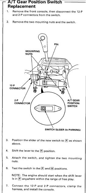

As an example of what you can find in the manual, see the attached
Then, I realize being without a car is not a good thing and money can be tight. So as a TEMP solution...TEMP ONLY please. Car in "P", put e-brake on to be sure. Then turn the key to the on/position II, you can..should be able to run a wire from the hot/+ side of the battery to the small terminal of the starter and get it started, once the engine is running remove wire, or starter will stay on-bad thing....just know you have to use this method everytime you want to start the car....not fun on cold mornings or in the parking lot at work
Attached Thumbnails No start...neutral safety switch question-5th-gen-select-wire-dia.jpg   No start...neutral safety switch question-5th-gen-gear-pos-switch.jpg
