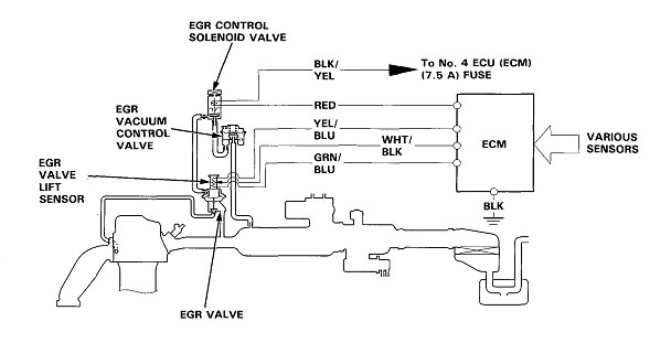

There's more to the EGR system than just the valve. Schematic from the factory service manual attached. the FSM has 4-1/2 pages of troubleshooting for a DTC 12. Do you have a FSM?

Unfortunately at the moment I do not have the manual. I should pick one up pretty quickly it seems like. Any suggestions where to get one. Ebay? or just any auto shop? Thanks!!
