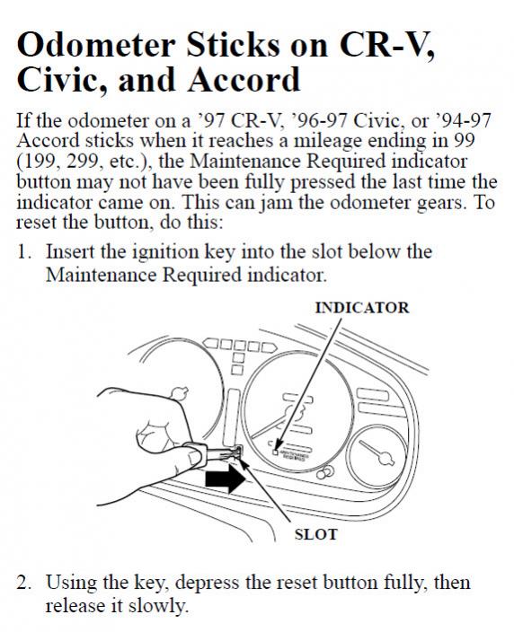

Both the odometers (not the speedometer) the trip and the total milage meters have stopped working??? I re-placed the VSS about 6 months ago.
know were to start or test to see were the problem is?
Old Jul 11, 2012 | 06:12 PM
Use your key several times in the trip meter reset slot to see if it will un-stick.
See attached pic.
