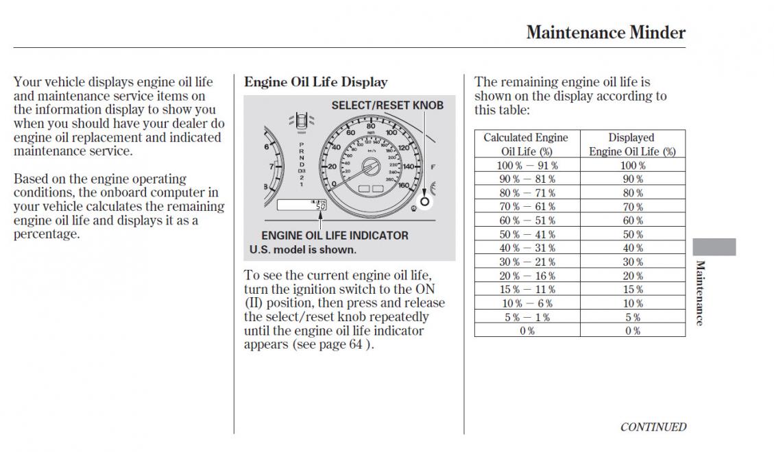

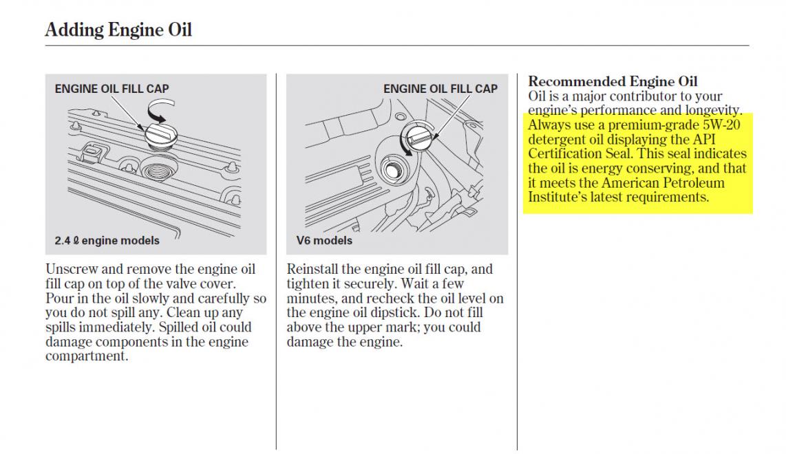

For the 2008-2010 Accords, the recommend engine oil is 5W-20 (Honda says displaying the API Certification Seal ). -- This would cover your 2009 Accord.
The car has a Maintenance Minder indicating calculated engine oil life. Keep in mind, the oil life is calculated based on engine operating conditions, etc.; it does not actually analyze the oil quality or the level.

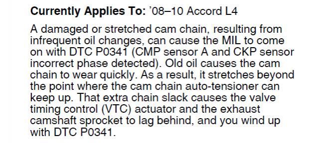

Generally, you will hear some people say to change it when it reach 15% oil life. With the exception of the first oil change (there is molybdenum in the engine to help during engine break-in), I personally would not go all the way to 15%. You can and may not experience any problems; however, there have been many people with stretched cam chains with the 4 cylinders due to infrequent oil changes or low oil levels. -- The 2003-2007 (7th generation) Accord 4 cylinders engines are relatively similar to the 2008-2012 (8th generation) Accord 4 cylinders (they are K24 engines with timing chains); and there have been a bunch of 7th generation Accord owners who had stretched chains.
So, in between frequent oil changes, always check your oil levels regularly.
