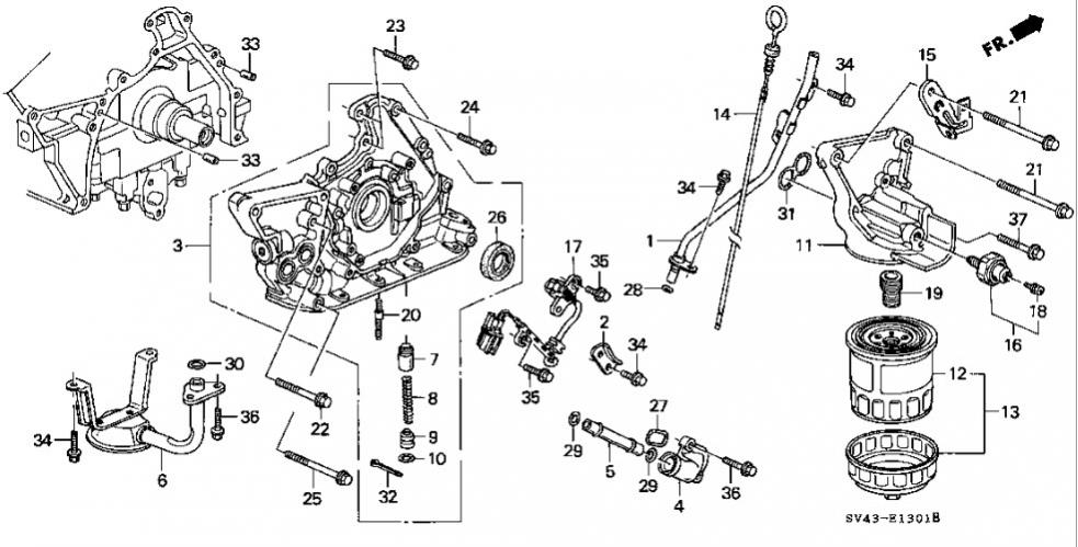

Originally Posted by nervousmom
The oil filter housing needs to be replaced. Any idea on cost at a reputable/trustworthy shop?
6, I believe.
It probably needs the o-ring replaced. Part # 31 should be the part. Honda part number 91318-PY3-000, oil pump gasket, list price $10.97. One of the bolts (#37 in the diagram) may be a little hard to get access to remove.
Attached Thumbnails Oil leak-broke after Christmas, please help-oil-filter-base.jpg
